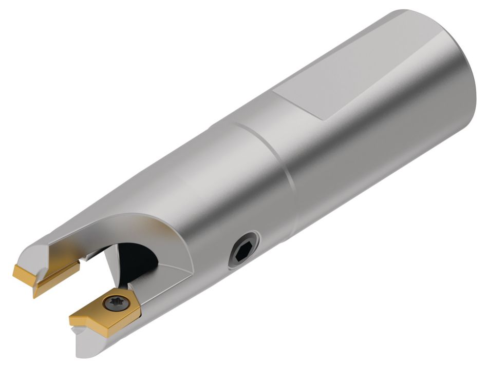

BF Combination Tool • Toolholder • WN Shank • Metric
Combination Tooling • Whistle Notch™ Shank (WN)
Material Number2951632

  • Shank - Cylindrical Whistle Notch™Shank - Cylindrical Whistle Notch™

[D33] Cut Diameter 3 19.4 mm
[D33] Cut Diameter 3 0.764 in
[D22] Cut Diameter 2 13.7 mm
[D22] Cut Diameter 2 0.539 in
[D1] Drill Diameter M 8.1 mm
[D1] Drill Diameter M 0.319 in
[D1MAX] Drill Diameter Maximum9 mm
[D1MAX] Drill Diameter Maximum0.354 in
[D4] Mount Bore Diameter 9 mm
[D4] Mount Bore Diameter 0.354 in
[L] Overall Length 97.3 mm
[L] Overall Length 3.831 in
[LS] Shank Length 50 mm
[LS] Shank Length 1.9685 in
[D] Adapter / Shank / Bore Diameter20 mm
[D] Adapter / Shank / Bore Diameter0.7874 in
  • For combined drilling and countersinking applications.
  • Applicable for solid carbide drills and KenTIP FS modular drills.
