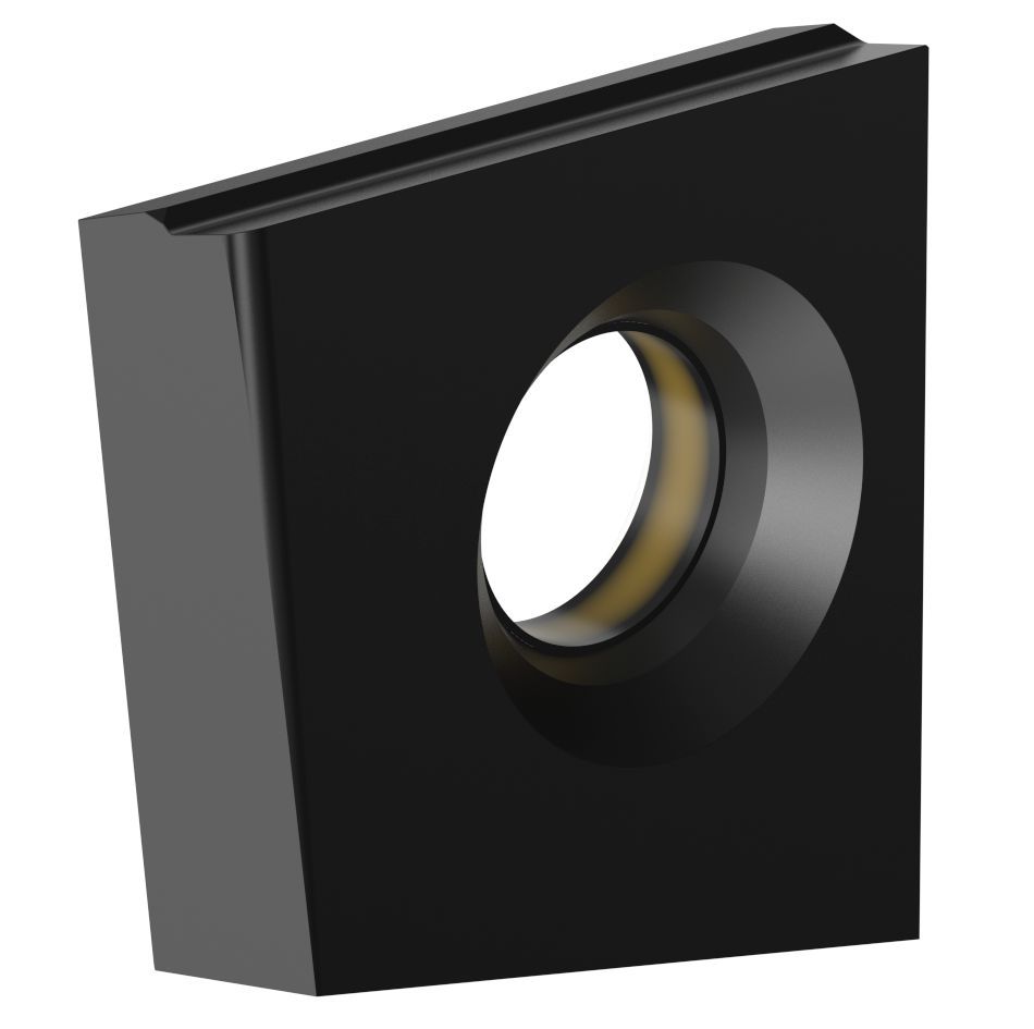

C2FIX-MN
Material Number4054491
ISO Catalog IDC2FIX150505LMNANSI Catalog IDC2FIX150505LMN
Fix-Perfect™ C2FIX150505LMN Tangentially Mounted Insert 4054491 - Kennametal
$32.44/each
Drawings for 4054491
GradeKCP25
[L10] Insert Cutting Edge Length14.7 mm
[L10] Insert Cutting Edge Length0.578 in
[S] Insert Thickness5 mm
[S] Insert Thickness0.197 in
[Rε] Corner Radius 0.5 mm
[Rε] Corner Radius 0.02 in
KCP25
KCP25
Composition: A tough cobalt-enriched carbide grade with a newly designed multilayer MTCVD-TiCN-Al2O3 coating with superior interlayer adhesion.
Application: Best general-purpose turning grade for most steels and ferritic and martensitic stainless steels. The substrate design ensures adequate deformation resistance with excellent insert edge strength. Coating layers offer good wear resistance over a wide range of machining conditions and the post-coat treatment minimises microchipping and improves coating adhesion to substrate leading to long tool life and improved workpiece finishes.
