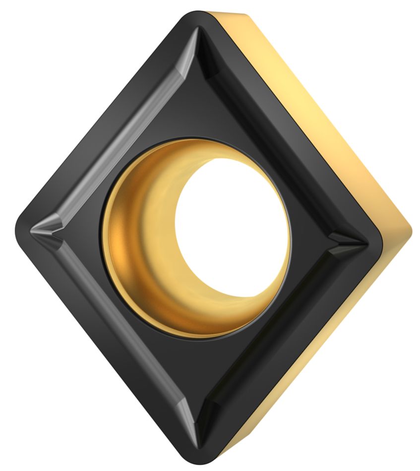

CCMT-LF
Screw-On Inserts
Material Number7088288
ISO Catalog IDCCMT060204LFANSI Catalog IDCCMT2151LF
CCMT-LF Turning - 7088288 - Kennametal
$17.63/each
Drawings for 7088288
GradeKCP25C
[D] Insert IC Size6.35 mm
[D] Insert IC Size0.25 in
[D1] Insert Hole Size 2.9 mm
[D1] Insert Hole Size 0.1142 in
[L10] Insert Cutting Edge Length6.448 mm
[L10] Insert Cutting Edge Length0.2539 in
[S] Insert Thickness2.38 mm
[S] Insert Thickness0.0938 in
[Rε] Corner Radius 0.4 mm
[Rε] Corner Radius 0.016 in
  • Finishing geometry with light cutting action
  • Used in multiple material groups
