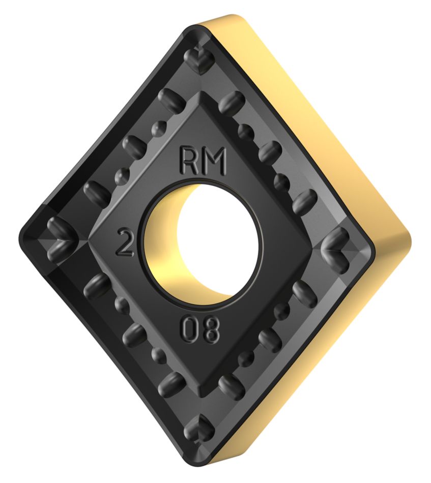

Kenloc™ Inserts
Material Number3751718
ISO Catalog IDCNMM160612RMANSI Catalog IDCNMM543RM
Kenloc™ CNMM ISO/ANSI Turning Insert 3751718 - Kennametal
GradeKCP25
[D] Insert IC Size15.875 mm
[D] Insert IC Size0.625 in
[L10] Insert Cutting Edge Length16.12 mm
[L10] Insert Cutting Edge Length0.6346 in
[S] Insert Thickness6.35 mm
[S] Insert Thickness0.25 in
[Rε] Corner Radius 1.2 mm
[Rε] Corner Radius 0.047 in
[D1] Insert Hole Size 6.35 mm
[D1] Insert Hole Size 0.25 in
KCP25
KCP25
Composition: A tough cobalt-enriched carbide grade with a newly designed multilayer MTCVD-TiCN-Al2O3 coating with superior interlayer adhesion.
Application: Best general-purpose turning grade for most steels and ferritic and martensitic stainless steels. The substrate design ensures adequate deformation resistance with excellent insert edge strength. Coating layers offer good wear resistance over a wide range of machining conditions and the post-coat treatment minimises microchipping and improves coating adhesion to substrate leading to long tool life and improved workpiece finishes.
