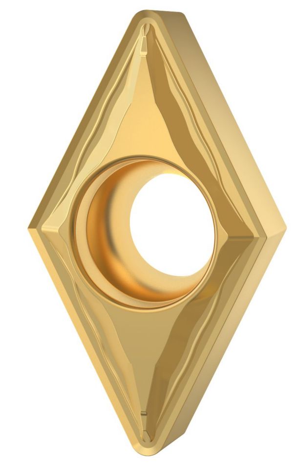

Material Number7167804
ISO Catalog IDDCMT11T302FP
ANSI Catalog IDDCMT32505FP
GradeKCU25B
[D] Insert IC Size9.525 mm
[D] Insert IC Size0.375 in
[D1] Insert Hole Size 4.4 mm
[D1] Insert Hole Size 0.1732 in
[L10] Insert Cutting Edge Length11.628 mm
[L10] Insert Cutting Edge Length0.4578 in
[S] Insert Thickness3.97 mm
[S] Insert Thickness0.1563 in
[Rε] Corner Radius 0.2 mm
[Rε] Corner Radius 0.008 in
  • Finishing geometry with positive rake face for chip control in difficult materials
