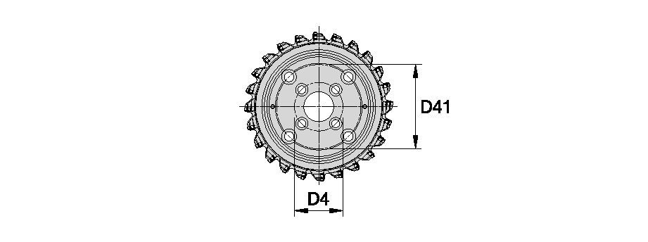

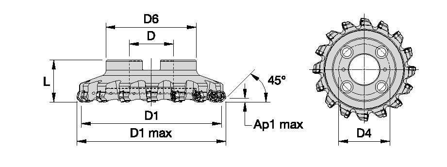

[D1] Effective Cutting Diameter304.8 mm
[D1] Effective Cutting Diameter12 in
[D1MAX] Maximum Cutting Diameter315.791 mm
[D1MAX] Maximum Cutting Diameter12.433 in
[D] Adapter / Shank / Bore Diameter63.5 mm
[D] Adapter / Shank / Bore Diameter2.5 in
[D4] Bolt Circle 4101.6 mm
[D4] Bolt Circle 34 in
[D41] Bolt Circle 2 177.8 mm
[D41] Bolt Circle 2 7 in
[D6] Hub Diameter 229 mm
[D6] Hub Diameter 9.016 in
[L] Overall Length 80 mm
[L] Overall Length 3.15 in
[AP1MAX] 1st Maximum Cutting Depth4.5 mm
[AP1MAX] 1st Maximum Cutting Depth0.177 in
