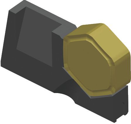

ANVIL R FINISHING 0 25°-CORRECTED
2033468
12748503400
12748503400
