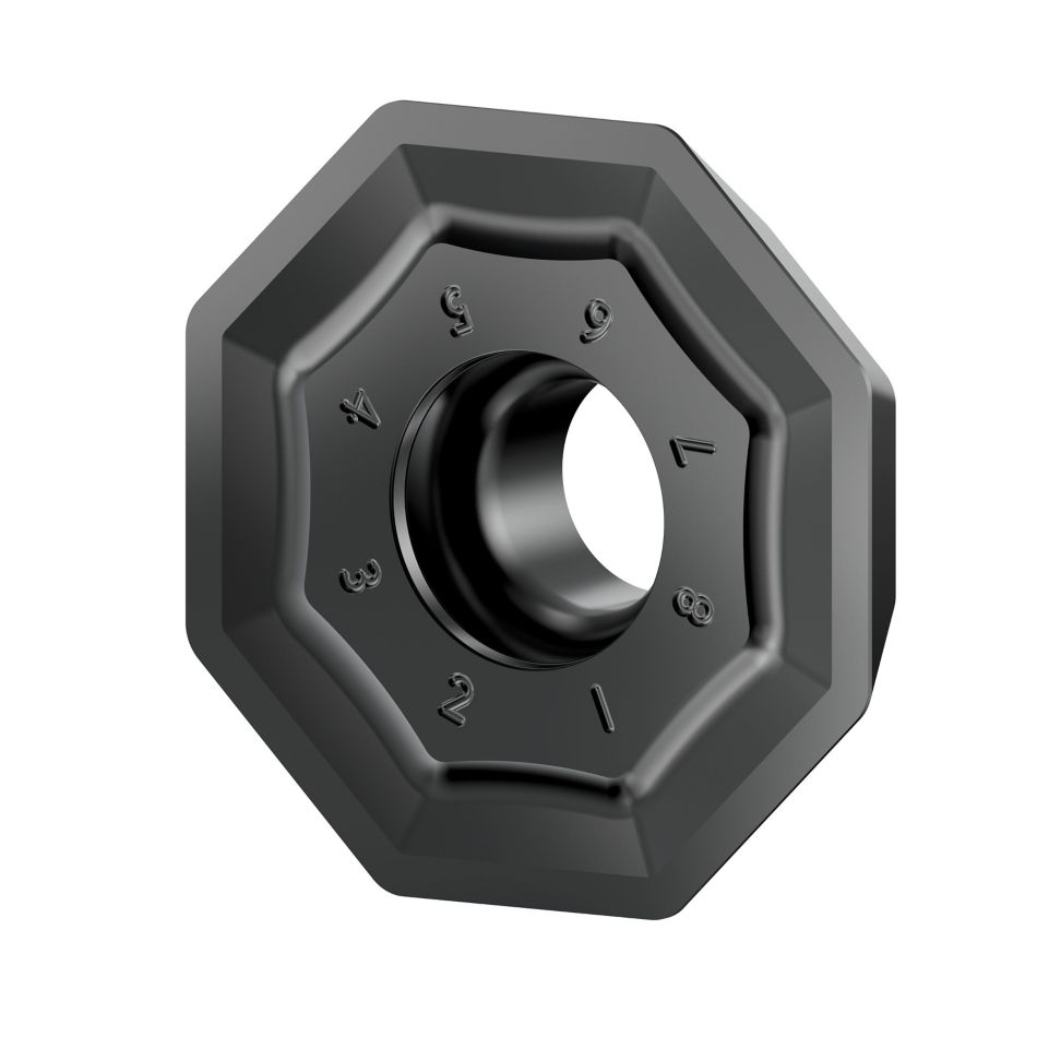

KSOM™ • Carbide Insert • OFPT-GB • Medium Machining
Face milling insert with eight cutting edges.
Material Number2047701
ISO Catalog IDOFPT07L6AFENGBANSI Catalog IDOFPT64AFEN6GB
- P Steel
- M Stainless Steel
- K Cast Iron
- S High-Temp Alloys
- H Hardened Materials
| Material Number | 2047701 |
| ISO Catalog ID | OFPT07L6AFENGB |
| ANSI Catalog ID | OFPT64AFEN6GB |
| Grade | KC522M |
| [D] Insert IC Size | 18.7 mm |
| [D] Insert IC Size | 0.736 in |
| [S] Insert Thickness | 6 mm |
| [S] Insert Thickness | 0.2362 in |
| [L10] Insert Cutting Edge Length | 7.5 mm |
| [L10] Insert Cutting Edge Length | 0.295 in |
| [Rε] Corner Radius | 1.2 mm |
| [Rε] Corner Radius | 0.047 in |
| Average Chip Thickness [HM] | 0.15 mm |
| Average Chip Thickness [HM] | 0.0059 in |
| Cutting Edges per Insert | 8 |
- Steel
- Stainless Steel
- Cast Iron
- High-Temp Alloys
- Hardened Materials
KC522M
Coated carbide grade with a AlTiN (PVD) coating. KC522M is engineered to provide better performance in general machining of steel, stainless steel, cast iron, and high-temperature alloys. KC522M resists breakage and offers improved wear resistance and increased strength.
- Pressed-to-size, for lowest cost per cutting edge.
- High positive rake face for soft cutting action.
- Low cutting forces deliver higher feed capabilities.
- 25° clearance angle for excellent free-cutting.
