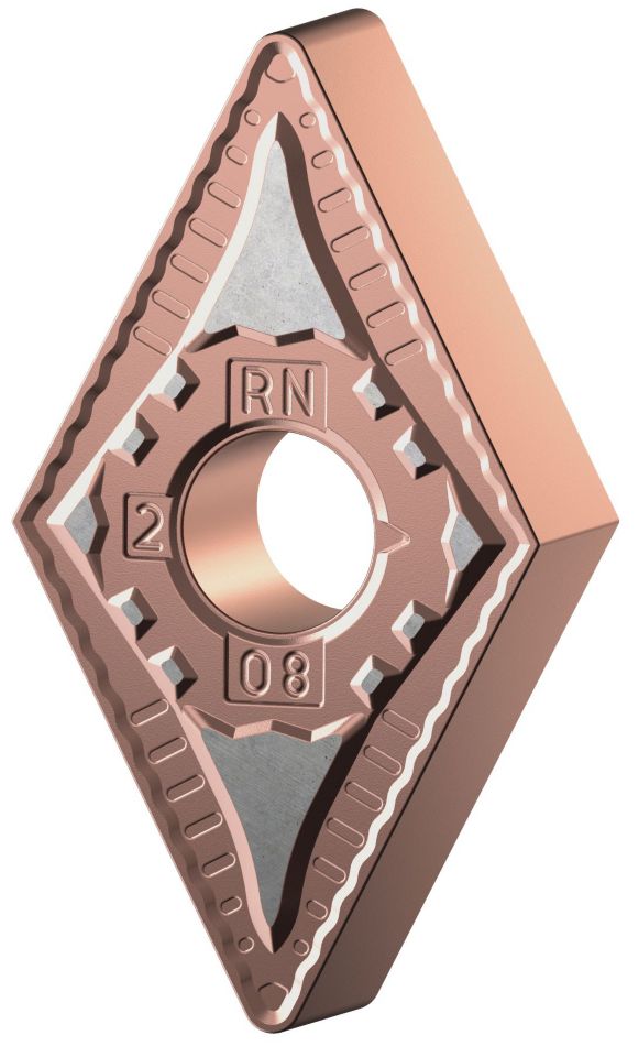

DNMG-RN
ISO Turning Carbide Insert • Roughing Negative Geometry
Material Number5591998
ISO Catalog IDDNMG150616RNANSI Catalog IDDNMG444RN
Kenloc™ DNMG ISO/ANSI Turning Insert 5591998 - Kennametal
$57.29/each
Drawings for 5591998
GradeKCP40B
[D] Insert IC Size12.7 mm
[D] Insert IC Size0.5 in
[D1] Insert Hole Size 5.16 mm
[S] Insert Thickness6.35 mm
[S] Insert Thickness0.25 in
[Rε] Corner Radius 1.6 mm
[Rε] Corner Radius 0.063 in
KCP40B
KCP40B
Composition: A tough carbide grade with a moderately thick TiN-MT-TiCN-Al2O3 coating.
Application: For heavy roughing of carbon, alloy, and stainless steels. The substrate-coating combination provides unbelievable toughness and operational security allowing high metal removal rates even in most demanding interrupted cuts.
  • Roughing geometry with stronger edge line for demanding applications
