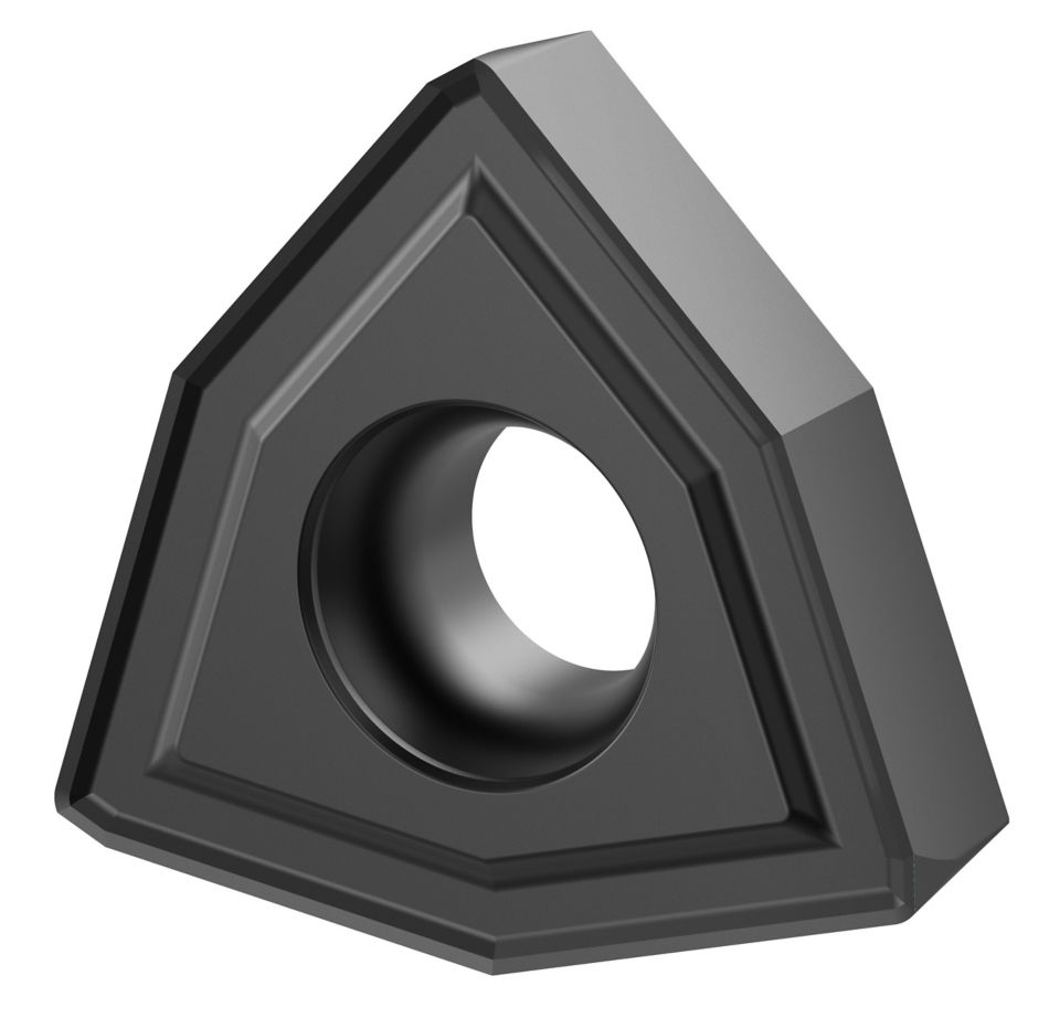

KSEM PLUS™ • Outboard Insert • DFT-HP Geometry
Modular Drilling • Carbide Insert for KSEM PLUS™ A1 Heads
Material Number5067489
ISO Catalog IDDFT06T308D36HPANSI Catalog IDDFT06T308D36HP
KSEMP DFT-HP Holemaking - 5067489 - Kennametal
$38.21/each
Drawings for 5067489
GradeKCU25
[L10] Insert Cutting Edge Length6.62 mm
[L10] Insert Cutting Edge Length0.26 in
[D] Insert IC Size10 mm
[D] Insert IC Size0.394 in
[D1] Insert Hole Size 4.4 mm
[D1] Insert Hole Size 0.173 in
[S] Insert Thickness3.75 mm
[S] Insert Thickness0.148 in
[Rε] Corner Radius 0.8 mm
[Rε] Corner Radius 0.031 in
KCU25
KCU25
Composition: An advanced PVD grade with hard AlTiN coating and fine-grain unalloyed substrate. The new and improved coating improves edge stability with wide range speed and feed capabilities.
Application: The KCU25™ grade is ideal for general machining of most steels, stainless steels, high-temp alloys, titanium, irons, and non-ferrous materials in a wide range of speeds and feeds with improved edge toughness for interrupted cuts and high feed rates.
  • Drilling insert for primary application in steels, cast iron and high temperature alloys
  • Three cutting edges
  • Outboard insert for diameter range 31,75-101,60mm (1.250-4.000")
