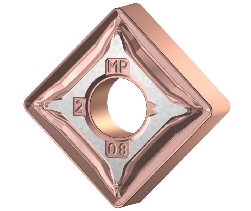

SNMG-MP
Kenloc™ Inserts
Material Number5591951
ISO Catalog IDSNMG190616MPANSI Catalog IDSNMG644MP
Kenloc™ SNMG ISO/ANSI Turning Insert 5591951 - Kennametal
$62.47/each
Drawings for 5591951
GradeKCM25B
[D] Insert IC Size19.05 mm
[D] Insert IC Size0.75 in
[D1] Insert Hole Size 7.92 mm
[D1] Insert Hole Size 0.312 in
[L10] Insert Cutting Edge Length19.05 mm
[L10] Insert Cutting Edge Length0.75 in
[S] Insert Thickness6.35 mm
[S] Insert Thickness0.25 in
[Rε] Corner Radius 1.6 mm
[Rε] Corner Radius 0.063 in
KCM25B
KCM25B
Composition: A multilayer MTCVD-TiCN-Al2O3-TiOCN coated carbide grade.
Application: An excellent finishing to medium machining grade for austenitic stainless steels at higher speeds and covers a broad range of steel applications in the P20-25 range. KCM15 grade in combination with unique geometries have been designed to resist depth-of-cut notching and minimize burr formation. The post-coat treatment reduces coating stresses, improves coating adhesion, minimizes microchipping and edge build-up, and improves workpiece finish.
  • Medium geometry with positive rake face for chip control in difficult materials
