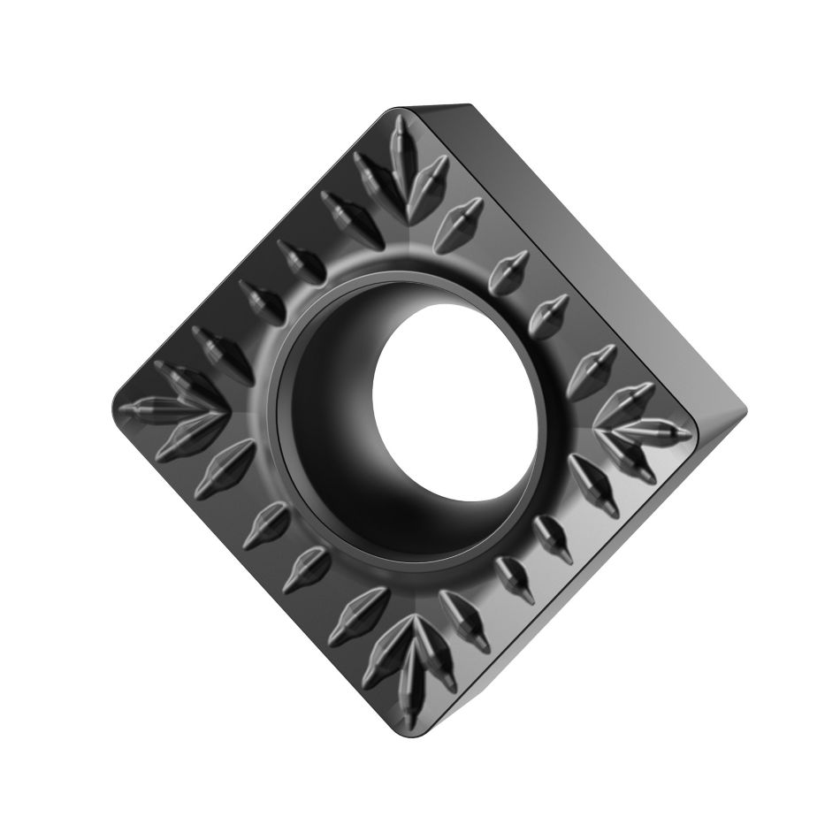

Material Number5591776
ISO Catalog IDSCMT09T308MP
ANSI Catalog IDSCMT3252MP
GradeKCM25B
[D] Insert IC Size9.525 mm
[D] Insert IC Size0.375 in
[D1] Insert Hole Size 4.4 mm
[D1] Insert Hole Size 0.1732 in
[L10] Insert Cutting Edge Length9.525 mm
[L10] Insert Cutting Edge Length0.375 in
[S] Insert Thickness3.969 mm
[S] Insert Thickness0.1563 in
[Rε] Corner Radius 0.8 mm
[Rε] Corner Radius 0.031 in
KCM25B
KCM25B
Composition: A multilayer MTCVD-TiCN-Al2O3-TiOCN coated carbide grade.
Application: An excellent finishing to medium machining grade for austenitic stainless steels at higher speeds and covers a broad range of steel applications in the P20-25 range. KCM15 grade in combination with unique geometries have been designed to resist depth-of-cut notching and minimize burr formation. The post-coat treatment reduces coating stresses, improves coating adhesion, minimizes microchipping and edge build-up, and improves workpiece finish.
  • Medium geometry with positive rake face for chip control in difficult materials
