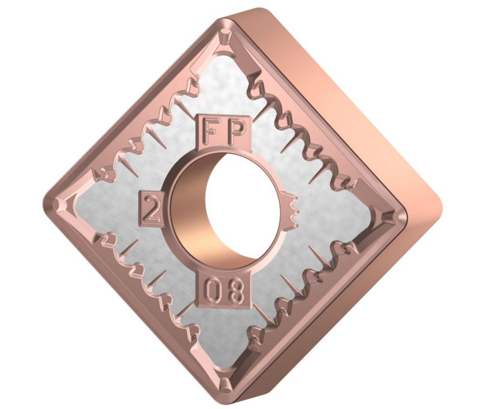

SNMG-FP
Kenloc™ Inserts
Material Number5591611
ISO Catalog IDSNMG120408FPANSI Catalog IDSNMG432FP
Kenloc™ SNMG ISO/ANSI Turning Insert 5591611 - Kennametal
GradeKCM25B
[D] Insert IC Size12.7 mm
[D] Insert IC Size0.5 in
[D1] Insert Hole Size 5.16 mm
[S] Insert Thickness4.76 mm
[S] Insert Thickness0.1875 in
[Rε] Corner Radius 0.8 mm
[Rε] Corner Radius 0.031 in
KCM25B
KCM25B
Composition: A multilayer MTCVD-TiCN-Al2O3-TiOCN coated carbide grade.
Application: An excellent finishing to medium machining grade for austenitic stainless steels at higher speeds and covers a broad range of steel applications in the P20-25 range. KCM15 grade in combination with unique geometries have been designed to resist depth-of-cut notching and minimize burr formation. The post-coat treatment reduces coating stresses, improves coating adhesion, minimizes microchipping and edge build-up, and improves workpiece finish.
  • Finishing geometry with positive rake face for chip control in difficult materials
