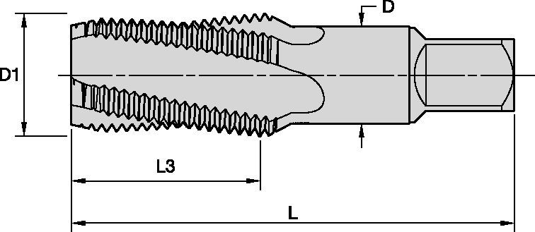

Drawings for 5629803
Material Number5629803
ISO Catalog IDT854NPT05000-14R-A
ANSI Catalog IDT854NPT05000-14R-A
GradeKSU31
[D1-TDZ] Thread Diameter Size1/2 - 14
[L] Overall Length 79.38 mm
[L] Overall Length 3.125 in
[L3] Thread Length 34.93 mm
[L3] Thread Length 1.375 in
[D] Adapter / Shank / Bore Diameter17.463 mm
[D] Adapter / Shank / Bore Diameter0.6875 in
[Z] Number of Flutes4
Thread Pitch StyleNPT
