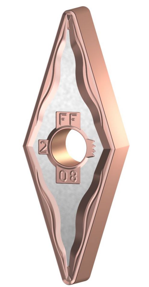

VNMG-FF
Kenloc™ Inserts
Material Number5697185
ISO Catalog IDVNMG160404FFANSI Catalog IDVNMG331FF
Kenloc™ VNMG ISO/ANSI Turning Insert 5697185 - Kennametal
$40.66/each
Drawings for 5697185
GradeKCP10B
Beyond Drive GradesBeyond™ Drive™
[D] Insert IC Size9.525 mm
[D] Insert IC Size0.375 in
[L10] Insert Cutting Edge Length16.606 mm
[L10] Insert Cutting Edge Length0.6538 in
[S] Insert Thickness4.763 mm
[S] Insert Thickness0.1875 in
[Rε] Corner Radius 0.4 mm
[Rε] Corner Radius 0.016 in
[D1] Insert Hole Size 3.81 mm
[D1] Insert Hole Size 0.15 in
KCP10B
KCP10B
Composition: A specially engineered cobalt-enriched carbide grade with thick MTCVD-TiCN-Al2O3-TiOCN coating for maximum wear resistance.
  • Finishing geometry for high-surface finish demands.
