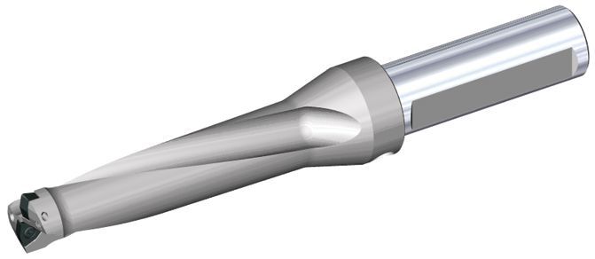

DFT Flanged Shank • Right Hand • 4 x D
Drill Fix™ DFT™ Bodies
Número de material1522132
Referencia ISODFT0750R4SSF125Referencia ANSIDFT0750R4SSF125

| Número de material | 1522132 |
| Referencia ISO | DFT0750R4SSF125 |
| Referencia ANSI | DFT0750R4SSF125 |
| Adaptador/Mango/Diá int [D] | 31.75 mm |
| Adaptador/Mango/Diá int [D] | 1.25 in |
| Diámetro de broca M [D1] | 19.05 mm |
| Diámetro de broca M [D1] | 0.75 in |
| Diámetro de broca máximo [D1MAX] | 21.59 mm |
| Diámetro de broca máximo [D1MAX] | 0.85 in |
| Longitud de calibre de plaquita [L1] | 114.3 mm |
| Longitud de calibre de plaquita [L1] | 4.5 in |
| Profundidad máxima de taladrado [L4] | 76.2 mm |
| Profundidad máxima de taladrado [L4] | 3 in |
| Longitud de punta de broca [L5] | 0.571 mm |
| Longitud de punta de broca [L5] | 0.0225 in |
| Calibre de plaquita | DFT0303. |

- Drill Fix DFT is one of the most versatile and reliable tool solutions covering a large diameter range and offers portfolio of insert geometries and grades.
- Trigon-shaped inserts are used for both inboard and outboard inserts and offer the highest centering capabilities and three cutting edges each.
- Drill shipped with insert screws, side pipe plug, and Torx wrench.
