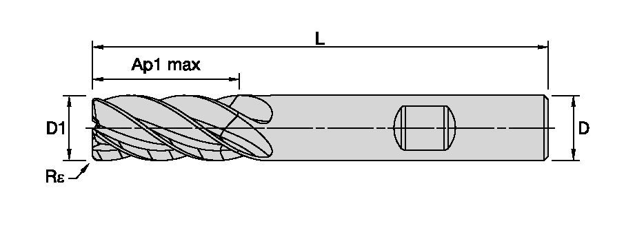

Número de material | 7155904 |
Referencia ISO | H2TE5RA0250S038HBR030 |
Referencia ANSI | H2TE5RA0250S038HBR030 |
Calidad | KCSM15A |
Tipo de adaptador Lateral de máquina | Weldon |
1.ª profundidad de corte máxima [AP1MAX] | 9.525 mm |
1.ª profundidad de corte máxima [AP1MAX] | 0.375 in |
Longitud total [L] | 50.8 mm |
Longitud total [L] | 2 in |
Radio de esquina [Re] | 0.75 mm |
Radio de esquina [Re] | 0.03 in |
Número de canales [Z] | 5 |
Diámetro de corte efectivo [D1] | 6.35 mm |
Diámetro de corte efectivo [D1] | 0.25 in |
Adaptador/Mango/Diá int [D] | 6.35 mm |
Adaptador/Mango/Diá int [D] | 0.25 in |

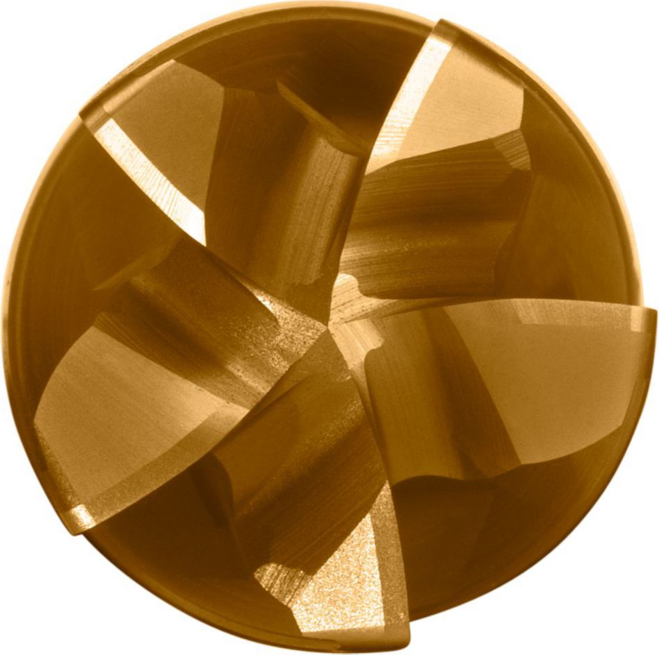

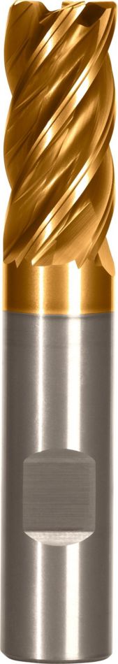

- Versatile solid carbide endmill for steels, stainless steel, high temperature alloys, and cast iron.
- Proprietary core and flute designs with optimum flute spacing for perfect chip formation and highest tool rigidity.
- Unique End Face Design for agressive ramping and plunging operations.
- Unequally spaced flutes and differential helix allow for the broadest range of applications.
- Chip gashes in the flutes ensure optimum chip removal.
- Eccentric relief provides edge stability in a broad range of materials.
- With Weldon Shank for economical pull-out protection.
