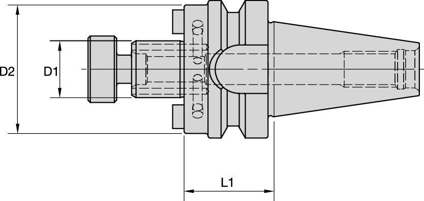

  • Shank - SK BT JIS B 6339Shank - SK BT JIS B 6339
Drawings for 3648598
Material Number3648598
ISO Catalog IDBT30SMC050118
ANSI Catalog IDBT30SMC050118
[D2] Body Diameter 1 Workpiece Side 36.5 mm
[D2] Body Diameter 1 Workpiece Side 1.437 in
[L1] Gage Length29.972 mm
[L1] Gage Length1.18 in
Cutter Retention Screw ID Drive Size3/16
Weight Pounds1.02
[D1] Adapter / Shank / Bore Diameter12.7 mm
[D1] Adapter / Shank / Bore Diameter0.5 in
