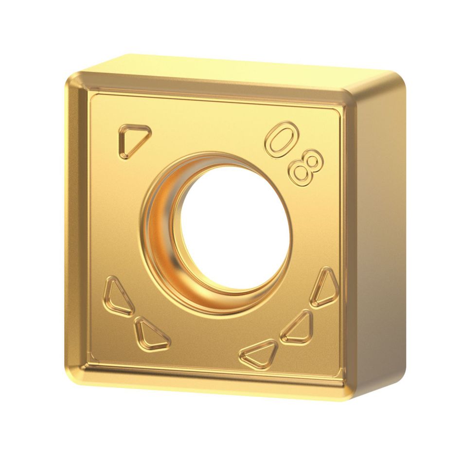

- Designed for aerospace airframe structural component machining, targeting maximum metal removal rates (MRR).
- Internal coolant supply.
- Adjustable coolant nozzles support chip evacuation and control heat in the cutting zone.
- Large helix ensures hassle-free chip evacuation event at highest metal removal rates (MRR).
