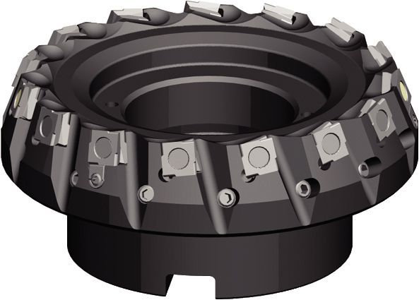

The Fix-Perfect 70° lead angle face milling system for cast iron and Compacted Graphite Iron (CGI) is designed for roughing and finishing applications. Engineered for high performance and efficiency, the milling cutters allow for high feed rates and rapid material removal due to tangentially mounted inserts. The adjustable pockets and wiper inserts offer precise control over the surface finish. The Fix-Perfect 70°’s range of carbide inserts feature periphery ground designs with either one or eight cutting edges, providing versatility and efficiency to meet various machining requirements. With honed cutting edges and wiper facets, these inserts ensure optimal performance and durability, delivering exceptional results in light to medium machining operations.
