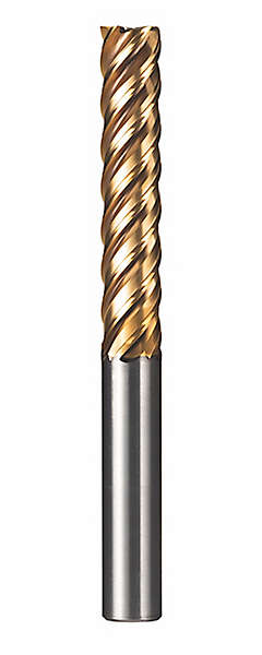

HARVI High-Performance End Mills
  • Eccentric relief improves edge stability and chip evacuation
  • Offer versatility and are ideal for machining a wide range of materials
  • Ensures longer tool life and makes them reliable for demanding tasks
  • Provide higher metal removal rates and feature through coolant capabilities
  • Ideal for all industries including aerospace, defense, medical, energy and general engineering

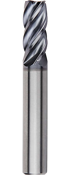

HARVI I

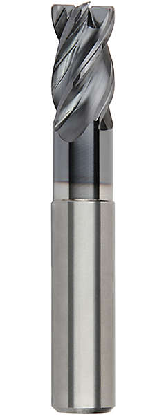

HARVI I TE

 Kennametal HARVI I High-Performance Solid Carbide End Mill
Kennametal HARVI I TE High-Performance Solid Carbide End MillKennametal HARVI II High-Performance Solid Carbide End MillKennametal HARVI II TE High-Performance Solid Carbide End MillKennametal HARVI II Long High-Performance Solid Carbide End MillKennametal HARVI III High-Performance Solid Carbide End MillKennametal HARVI II Aero High-Performance Solid Carbide End MillKennametal HARVI IV High-Performance Solid Carbide End Mill

HARVI I
HARVI I TE
