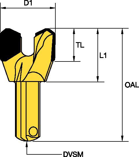

Drawings for 1011229
Material Number1011229
ISO Catalog IDRD1 3/8
ANSI Catalog IDRD1 3/8
GradeK3060
[D1] Drill Diameter Minimum 34.92 mm
[D1] Drill Diameter Minimum 1.375 in
[DVSM] Drive Size Machine Side1/2 SQUARE
[TL] Tip Length 20.32 mm
[TL] Tip Length 0.8 in
[L1] Gage Length 33 mm
[L1] Gage Length 1.3 in
[OAL] Overall Length 71.2 mm
[OAL] Overall Length 2.8 in
