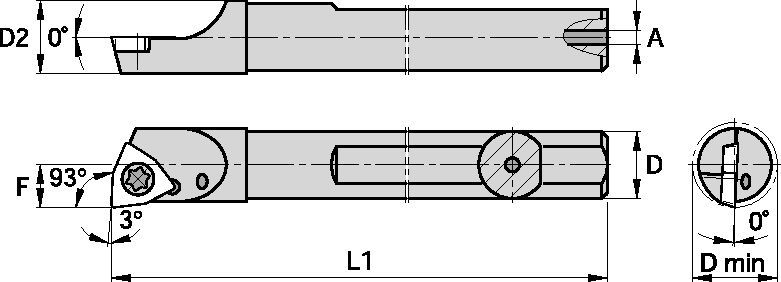

Drawings for 1930556
Material Number1930556
ISO Catalog IDA12MSWUPR04
ANSI Catalog IDA12MSWUPR04
[D] Adapter / Shank / Bore Diameter0.472 in
[DM] Minimum Bore Diameter 12.9 mm
[DM] Minimum Bore Diameter 0.508 in
[D2] Head Diameter 12.19 mm
[D2] Head Diameter 0.48 in
[F] F Dimension 6.55 mm
[F] F Dimension 0.258 in
[L1] Tool Length 152.4 mm
[L1] Tool Length 6 in
[A] Coolant Hole Diameter 4 mm
[A] Coolant Hole Dia 0.157 in
[CS] Coolant Supply Size1/16-27 NPT
Gage InsertWP..040204
Insert Screw ID Drive SizeT7
