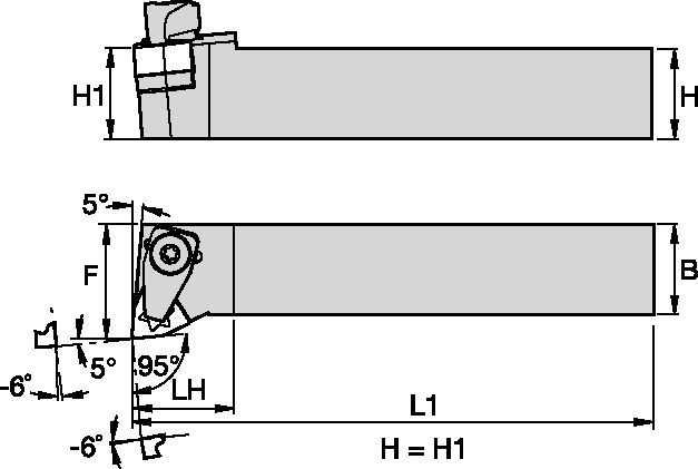

Drawings for 1873227
Material Number1873227
ISO Catalog IDCWLNR3225P08-MX7
ANSI Catalog IDCWLNR3225P08MX7
[H] Shank Height 32 mm
[H] Shank Height 1.2598 in
[B] Shank Width 25 mm
[B] Shank Width 0.9843 in
[F] F Dimension 32 mm
[F] F Dimension 1.2598 in
[L1] Tool Length 170 mm
[L1] Tool Length 6.6929 in
[LH] Head Length 32 mm
[LH] Head Length 1.2598 in
Gage InsertWN.X080708
Shim Screw ID Drive Size2.5 mm
Clamp Screw ID Drive Size4 mm
