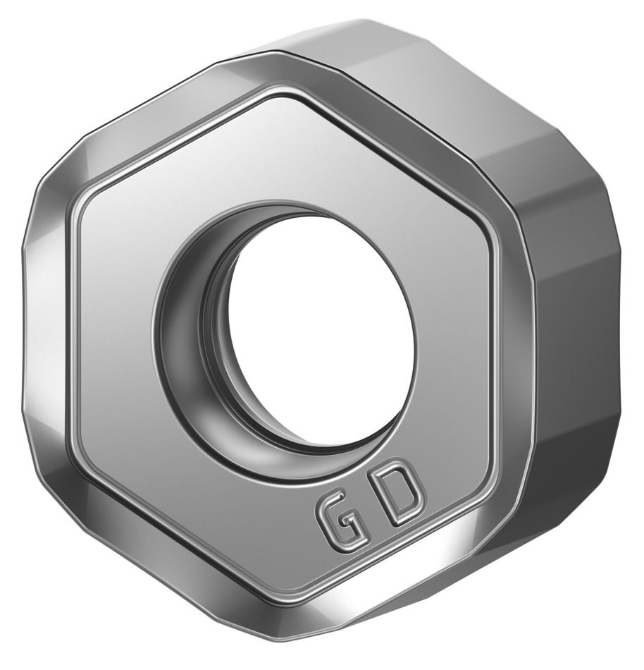

Face milling insert with twelve cutting edges
Material Number4119697
ISO Catalog IDHNPJ0604ANSNGDANSI Catalog IDHNPJ43ANSNGD
Dodeka™ Mini - Carbide Insert - HNPJ-GD - Medium Machining 4119697 - Kennametal
$24.63/each
Drawings for 4119697
GradeKC522M
[D] Insert IC Size12 mm
[D] Insert IC Size0.472 in
[BS] Corner Facet Length 1.452 mm
[BS] Corner Facet Length 0.0572 in
[L10] Insert Cutting Edge Length6.928 mm
[L10] Insert Cutting Edge Length0.2728 in
[Rε] Corner Radius 1 mm
[Rε] Corner Radius 0.039 in
[S] Insert Thickness4.445 mm
[S] Insert Thickness0.175 in
Average Chip Thickness [HM]0.082 mm
Average Chip Thickness [HM]0.0032 in
Cutting Edges per Insert12
KC522M
KC522M
Coated carbide grade with a AlTiN (PVD) coating. KC522M is engineered to provide better performance in general machining of steel, stainless steel, cast iron, and high-temperature alloys. KC522M resists breakage and offers improved wear resistance and increased strength.
  • Pressed-to-size, for lowest cost per cutting edge
  • Insert for Dodeka Mini 15/45/60 cutters (metric)
  • Insert for Dodeka Mini 75/45/30 cutters (inch)
