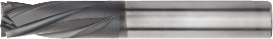

KenCut™ CF • CCNC • Chamfered • 4 Flutes • Internal Coolant • Plain Shank • Metric
KenCut™ CF Solid Carbide End Mill for CFRP
Material Number6447195
ISO Catalog IDCCNC0800A4AHANSI Catalog IDCCNC0800A4AH
KenCut CF Solid Carbide End Mill - CCNC - Chamfered - 4 Flutes - Internal Coolant - Plain Shank - Grade KCN05 - 6447195 - Kennametal.com

  • Helix Angle: 25°Helix Angle: 25°

GradeKCN05
[D1] Effective Cutting Diameter8 mm
[D1] Effective Cutting Diameter0.315 in
[D] Adapter / Shank / Bore Diameter8 mm
[D] Adapter / Shank / Bore Diameter0.315 in
[AP1MAX] 1st Maximum Cutting Depth18 mm
[AP1MAX] 1st Maximum Cutting Depth0.709 in
[L] Overall Length 83 mm
[L] Overall Length 3.268 in
[BCH] Corner Chamfer Width 0.127 mm
[BCH] Corner Chamfer Width 0.005 in
[Z] Number of Flutes4
  • CFRP Materials
KCN05
KCN05
High-performance grade A pure, diamond-coated carbide for milling CFRP and graphite. It is a very tough and wear-resistant grade.
  • Solid carbide end mill for carbon fibre reinforced parts maching (CFRP).
  • Solid carbide end mill for composite and fibre glass machining.
  • Compression-style router for trimming applications, promotes stable cutting conditions.
  • Up-Cut-Down-Cut geometry directs cutting forces towards the workpiece and prevents delamination.
  • Centre cutting for ramping operations.
