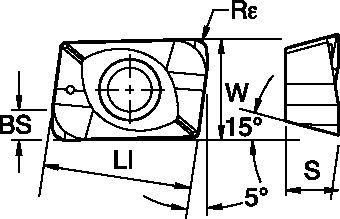

Drawings for 1855169
Material Number1855169
ISO Catalog IDADKT103504PDERLC
ANSI Catalog IDADKT16221PDERLC
GradeKC725M
[LI] Insert Length 10 mm
[LI] Insert Length 0.3937 in
[S] Insert Thickness3.5 mm
[S] Insert Thickness0.1378 in
[W] Insert Width 6.7 mm
[W] Insert Width 0.264 in
[BS] Corner Facet Length 2 mm
[BS] Corner Facet Length 0.0787 in
[Rε] Corner Radius 0.4 mm
[Rε] Corner Radius 0.016 in
Average Chip Thickness [HM]0.064 mm
Average Chip Thickness [HM]0.0025 in
Cutting Edges per Insert2
