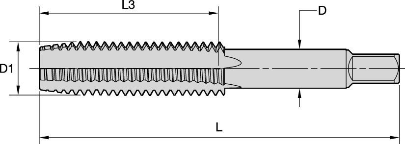

Drawings for 1543744
Material Number1543744
ISO Catalog IDKHSST27729
ANSI Catalog IDKHSST27729
CoatingUncoated
[D1-TDZ] Thread Diameter SizeM4 X 0.7
[L] Overall Length 53.975 mm
[L] Overall Length 2.125 in
[L3] Thread Length 19.05 mm
[L3] Thread Length 0.75 in
[D] Adapter / Shank / Bore Diameter4.267 mm
[D] Adapter / Shank / Bore Diameter0.168 in
[Z] Number of Flutes4
Tap Pitch Diameter LimitD4
Type of ThreadMETRIC
