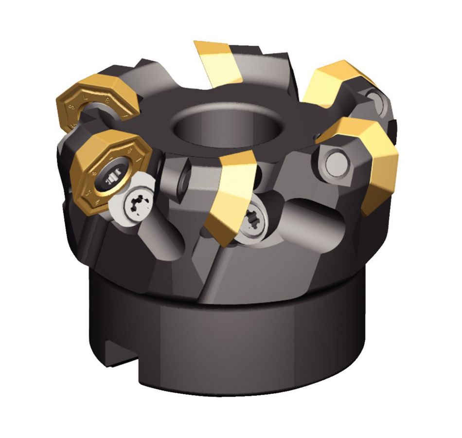

Material Number2465324
ISO Catalog IDKFSR300OF5345F4
ANSI Catalog IDKFSR300OF5345F4
[D1] Effective Cutting Diameter76.2 mm
[D1] Effective Cutting Diameter3 in
[D1MAX] Maximum Cutting Diameter84.912 mm
[D1MAX] Maximum Cutting Diameter3.343 in
[D6] Hub Diameter 55.6 mm
[D6] Hub Diameter 2.189 in
[L] Overall Length 44.45 mm
[L] Overall Length 1.75 in
[AP1MAX] 1st Maximum Cutting Depth3.5 mm
[AP1MAX] 1st Maximum Cutting Depth0.138 in
Number of Inserts9
Weight Pounds2.02
Max RPM8350
  • Face MillingFace Milling
  • Eight cutting edges.
  • Super soft cutting.
