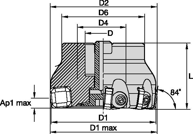

Drawings for 2466100
Material Number2466100
ISO Catalog ID160C24LF84SN12B
ANSI Catalog ID160C24LF84SN12B
[D1] Effective Cutting Diameter160 mm
[D1] Effective Cutting Diameter6.2992 in
[D1MAX] Maximum Cutting Diameter162 mm
[D1MAX] Maximum Cutting Diameter6.378 in
[D] Adapter / Shank / Bore Diameter1.5748 in
[D2] Maximum Body Diameter160.24 mm
[D2] Maximum Body Diameter6.3087 in
[D4] Bolt Circle 466.7 mm
[D4] Bolt Circle 32.626 in
[D6] Hub Diameter 90 mm
[D6] Hub Diameter 3.5433 in
[L] Overall Length 63 mm
[L] Overall Length 2.4803 in
[AP1MAX] 1st Maximum Cutting Depth5 mm
[AP1MAX] 1st Maximum Cutting Depth0.1969 in
Number of Inserts24
Weight Kilograms3.9
Max RPM3000
  • Face MillingFace Milling
  • Milling cutters for cast iron and compacted graphite iron (CGI) machining.
  • Perfect solution for any production with transfer lines.
  • KSSR produces excellent surface finishes due to high axial and radial accuracy.
  • High feed rate capability.
  • Easy indexing through wedge clamping.
  • Cutters come with coolant shower plate.
