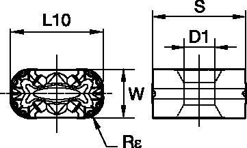

Drawings for 5596899
Material Number5596899
ISO Catalog IDLNUX301940RRP
ANSI Catalog IDLNUX301940RRP
GradeKCP25
[W] Insert Width 12 mm
[W] Insert Width 0.4724 in
[L10] Insert Cutting Edge Length30 mm
[L10] Insert Cutting Edge Length1.1811 in
[S] Insert Thickness19.05 mm
[S] Insert Thickness0.75 in
[Rε] Corner Radius 4 mm
[Rε] Corner Radius 0.157 in
[D1] Insert Hole Size 6.35 mm
[D1] Insert Hole Size 0.25 in
