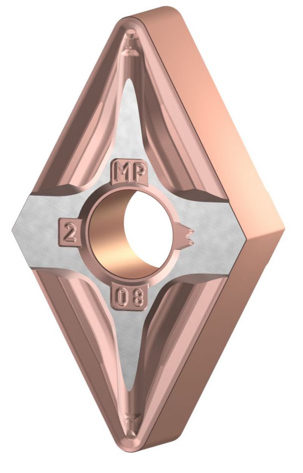

DNMG-MP
Kenloc™ Inserts
Material Number5641102
ISO Catalog IDDNMG150608MPANSI Catalog IDDNMG442MP
Kenloc™ DNMG ISO/ANSI Turning Insert 5641102 - Kennametal
$57.29/each
Drawings for 5641102
GradeKCM15B
[D] Insert IC Size12.7 mm
[D] Insert IC Size0.5 in
[D1] Insert Hole Size 5.156 mm
[S] Insert Thickness6.35 mm
[S] Insert Thickness0.25 in
[Rε] Corner Radius 0.8 mm
[Rε] Corner Radius 0.031 in
KCM15B
KCM15B
Composition: A multilayer MTCVD-TiCN-Al2O3 coated carbide grade.
Application: An excellent finishing to medium machining grade for austenitic stainless steels at higher speeds and covers a broad range of steel applications in the P20-25 range. KCM15 grade in combination with unique geometries have been designed to resist depth-of-cut notching and minimize burr formation. The post-coat treatment reduces coating stresses, improves coating adhesion, minimizes microchipping and edge build-up, and improves workpiece finish.
  • Medium geometry with positive rake face for chip control in difficult materials
