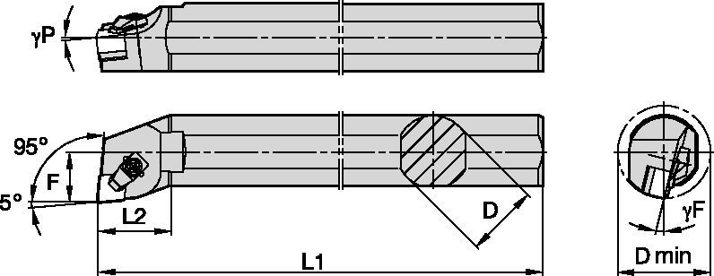

Drawings for 1289077
Material Number1289077
ISO Catalog IDS40T-CCLNR12-MX7
ANSI Catalog IDS40T-CCLNR12-MX7
[D] Adapter / Shank / Bore Diameter1.5748 in
[DM] Minimum Bore Diameter 55 mm
[DM] Minimum Bore Diameter 2.1654 in
[F] F Dimension 27 mm
[F] F Dimension 1.063 in
[L1] Tool Length 300 mm
[L1] Tool Length 11.811 in
[L2] Head Length 40 mm
[L2] Head Length 1.5748 in
[GAAP] Axial Rake Angle6
Gage InsertCN.X120708
Shim Screw ID Drive Size2.5 mm
Clamp Screw ID Drive Size4 mm
