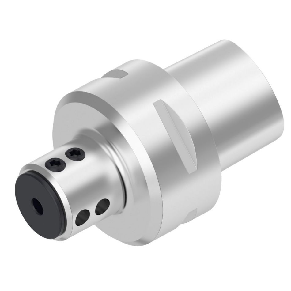

PSC Extensions and Reducers
Material Number6341312
ISO Catalog IDPSC63S40080MANSI Catalog IDPSC63S40080M

  • Manufacturer’s Specs: ISO 26623Manufacturer’s Specs: ISO 26623
  • Shank - PSCShank - PSC
  • Coolant: Through Coolant 80 bar MaximumCoolant: Through Coolant 80 bar Maximum
  • Coolant: Through Coolant 1200 psi MaximumCoolant: Through Coolant 1200 psi Maximum
Drawings for 6341312
[CSWS] System Size Workpiece SidePSC40
[D2] Body Diameter 1 Workpiece Side 40 mm
[D2] Body Diameter 1 Workpiece Side 1.5748 in
[L1] Gage Length80 mm
[L1] Gage Length3.1496 in
[L2] Usable Length 50.2 mm
[L2] Usable Length 1.9764 in
Weight Kilograms0.78
Torque Catalog Newton Meters55
Clamp Screw ID Drive Size8 mm
