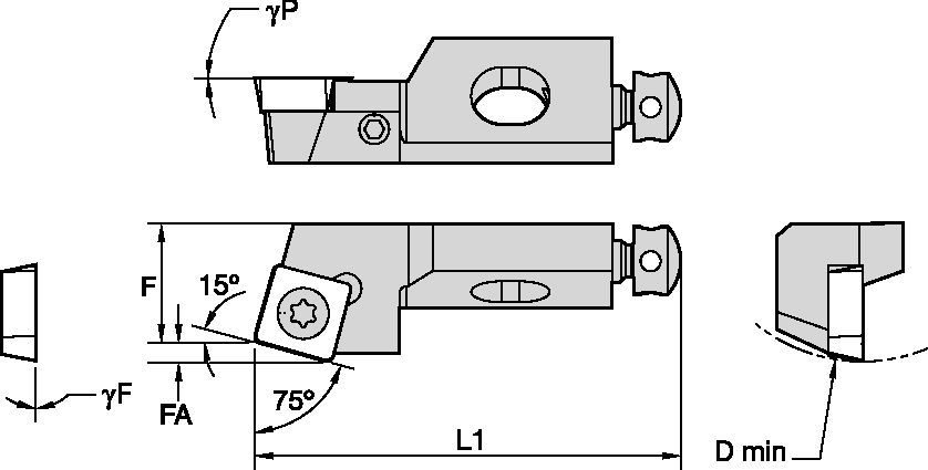

Drawings for 1098574
Material Number1098574
ISO Catalog IDSSRPR10CA09
ANSI Catalog IDSSRPR10CA09
[DM] Minimum Bore Diameter 40 mm
[DM] Minimum Bore Diameter 1.5748 in
[F] F Dimension 14 mm
[F] F Dimension 0.5512 in
[FA] F A Dimension 2.24 mm
[FA] F A Dimension 0.0882 in
[L1] Tool Length 50 mm
[L1] Tool Length 1.9685 in
[GAAP] Axial Rake Angle0
Gage InsertSP..09T308/SP..3252
