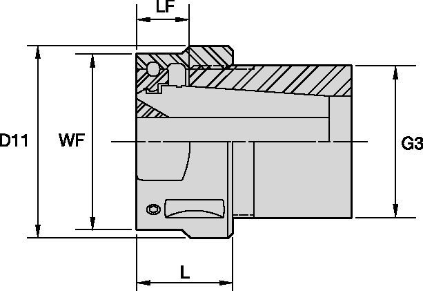

TG Locknut • Round Flush Face
TG Round Flush-Face Locknuts
Material Number2980880
ISO Catalog IDLNATGF075MANSI Catalog IDLNATGF075M
Material Number | 2980880 |
ISO Catalog ID | LNATGF075M |
ANSI Catalog ID | LNATGF075M |
Lock Nut Diameter [D11] | 50 mm |
Lock Nut Diameter [D11] | 1.969 in |
[L] Overall Length | 23.42 mm |
[L] Overall Length | 0.922 in |
[LF] Functional Length | 13.04 mm |
[LF] Functional Length | 0.513 in |
[WF] Width of Flat | 46 mm |
[WF] Width of Flat | 1.811 in |
[G3] Connection Thread Size Internal | 1 1/2-12 ACME |
Wrench | HSW45M |
Torque Catalog Newton Meters | 150 |
Torque Catalog Foot Pounds | 110 |
- TG flush mount, coolant-capable locknuts, and coolant disks/caps can be used on all standard TG collet chucks to seal standard TG collets.
- Face is completely flush.
- Includes the original ball bearing race design.
- External diameter is the same as existing global round TG locknut.
- Operated by a standard open-ended wrench or the original hook-style wrench.
- TG flush mount coolant capable locknuts and coolant disks/caps are interchangeable with existing designs.
- Utilizes standard TG collets.
