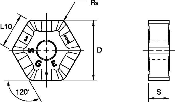

Drawings for 5615684
Material Number5615684
ISO Catalog IDHNPX090516SNGE
ANSI Catalog IDHNPX5354SNGE
GradeKCK15
[D] Insert IC Size16.2 mm
[D] Insert IC Size0.638 in
[S] Insert Thickness5.56 mm
[S] Insert Thickness0.2188 in
[L10] Insert Cutting Edge Length9.353 mm
[L10] Insert Cutting Edge Length0.3682 in
[Rε] Corner Radius 1.6 mm
[Rε] Corner Radius 0.063 in
Average Chip Thickness [HM]0.158 mm
Average Chip Thickness [HM]0.0062 in
Cutting Edges per Insert12
KCK15
KCK15
