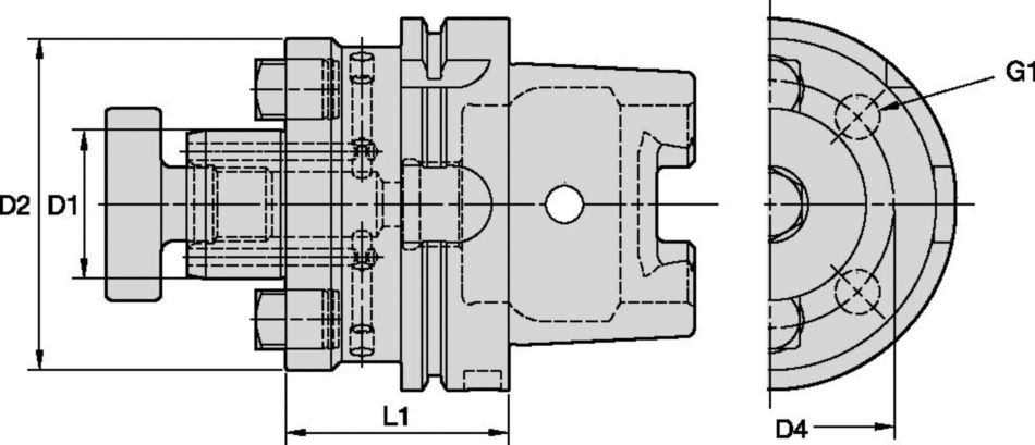

Drawings for 3872679
Material Number3872679
ISO Catalog IDHSK50ASMC22060M
ANSI Catalog IDHSK50ASMC22060M
[D1] Adapter / Shank / Bore Diameter22 mm
[D1] Adapter / Shank / Bore Diameter0.8661 in
[D2] Body Diameter 1 Workpiece Side 49 mm
[D2] Body Diameter 1 Workpiece Side 1.9291 in
[L1] Gage Length60 mm
[L1] Gage Length2.362 in
Cutter Retention Screw ID Drive Size8 mm
Weight Kilograms0.86
