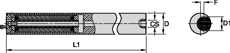

    Drawings for 6549457
    Material Number6549457
    ISO Catalog IDD100MHBB1445
    ANSI Catalog IDD100MHBB1445
    [D] Adapter / Shank / Bore Diameter100 mm
    [D] Adapter / Shank / Bore Diameter3.937 in
    [D1] Adapter / Shank / Bore Diameter50 mm
    [D1] Adapter / Shank / Bore Diameter1.9685 in
    [L1] Gage Length1409.293 mm
    [L1] Gage Length55.484 in
    [F] F Dimension 25 mm
    [F] F Dimension 0.9843 in
    [CS] Coolant Supply SizeRP 3/8-19
    Weight Kilograms81.2
    Clamp Screw ID Drive Size5 mm
