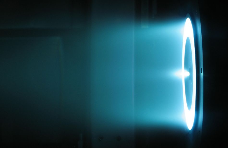

Xenon Hall-effect Thruster

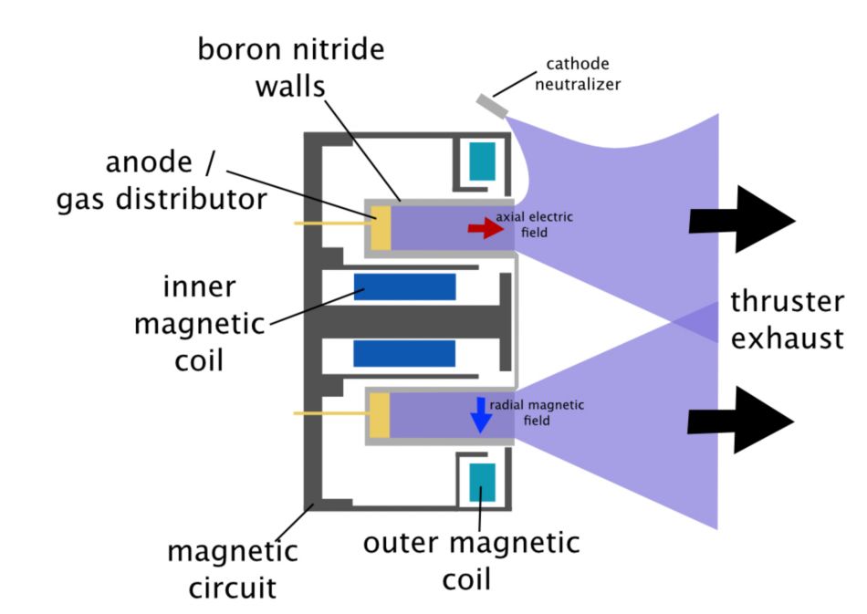

There are multiple space missions that use different propulsion methods, with Hall-effect thrusters being one of them. Both LEO and geostationary satellites use Hall-effect thrusters to control their orientation and positioning. These thrusters use a pair of inner magnetic coils that generate and maintain a large electromagnetic field in bulk plasma. The propellant can be xenon, krypton, or sometimes even iodine, which is turned into plasma by the electromagnetic field and high temperature generated by the coils. The electromagnetic field extracts positive ions from the plasma and accelerates them to high velocity to provide the necessary thrust. Plasma propulsion creates heat as high as 1500° C inside the thrusters’ channel walls. Over time, internal channel wall erosion caused by high heat and ionized particles colliding with the ceramic could become a serious concern when a satellite reaches the end of its operational life.
If the ceramic walls of the Hall-effect thrusters erode, the plasma starts to interreact with the magnetic circuit that slowly erodes as well. This is known as a “soft failure,” which can lead to a “hard failure” (loss of satellite). Recent work to reduce their size and power now makes Hall-effect thrusters a good solution for a wide range of LEO and geostationary satellites. Their working principles remain the same, but a race for lower cost and different lifetime target have a large bearing on the type of boron nitride ceramic composite used in satellite applications.

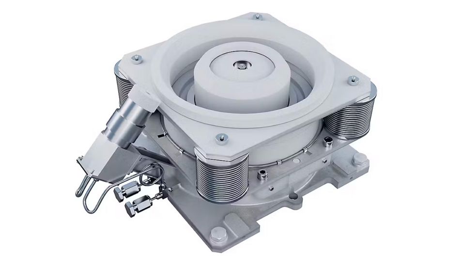

Kennametal Sintec BNP-6 is a hot-pressed ceramic composite of boron nitride and silica. This advanced material provides durable thermal shock resistance for orbiting satellites that experience back-and-forth swings in temperature extremes. It also has superior mechanical strength yet is easily machinable. Additionally, BNP-6 is an electrical insulator that offers a high dielectric strength and excellent resistance to wear and ceramic erosion, plus it is transparent to the electromagnetic field that accelerates the propellant and has low secondary electron emission, making it the perfect choice for the channel walls of Hall-effect thrusters.
