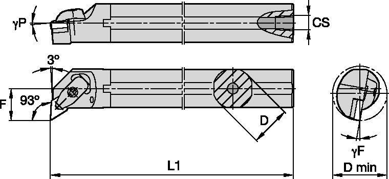

Drawings for 2441950
Material Number2441950
ISO Catalog IDA50UDDUNL15KC06
ANSI Catalog IDA50UDDUNL15KC06
[D] Adapter / Shank / Bore Diameter50 mm
[D] Adapter / Shank / Bore Diameter1.969 in
[DM] Minimum Bore Diameter 63 mm
[DM] Minimum Bore Diameter 2.48 in
[F] F Dimension 35 mm
[F] F Dimension 1.378 in
[L1] Tool Length 350 mm
[L1] Tool Length 13.78 in
[CS] Coolant Supply Size1/4-18 NPT
[GAAP] Axial Rake Angle5
Gage InsertDN..150608
Shim Screw ID Drive Size15 IP
Clamp Screw ID Drive Size15 IP
  • CFRP Materials
  • I.D. TurningI.D. Turning
  • Back BoringBack Boring
