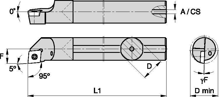

Drawings for 1152856
Material Number1152856
ISO Catalog IDE08KSCLPR06A
ANSI Catalog IDE08KSCLPR06A
[D] Adapter / Shank / Bore Diameter8 mm
[D] Adapter / Shank / Bore Diameter0.315 in
[DM] Minimum Bore Diameter 11 mm
[DM] Minimum Bore Diameter 0.4331 in
[F] F Dimension 5.875 mm
[F] F Dimension 0.2313 in
[L1] Tool Length 123.25 mm
[L1] Tool Length 4.8524 in
[A] Coolant Hole Diameter 2.362 mm
[A] Coolant Hole Dia 0.093 in
Gage InsertCP..060204
Insert Screw ID Drive SizeT7
