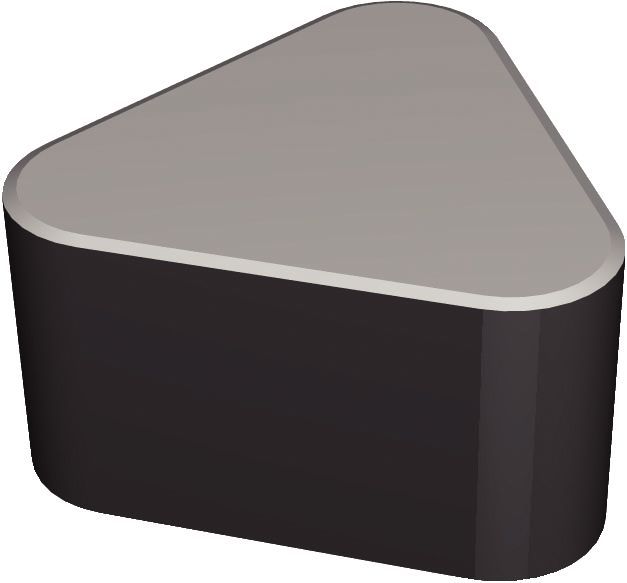

Drawings for 6082250
Material Number6082250
ISO Catalog IDTNGN160416S02020
ANSI Catalog IDTNGN334S0820
GradeKBK45
[D] Insert IC Size9.525 mm
[D] Insert IC Size0.375 in
[L10] Insert Cutting Edge Length16.5 mm
[L10] Insert Cutting Edge Length0.65 in
[S] Insert Thickness4.762 mm
[S] Insert Thickness0.1875 in
[Rε] Corner Radius 1.6 mm
[Rε] Corner Radius 0.063 in
KBK45
KBK45

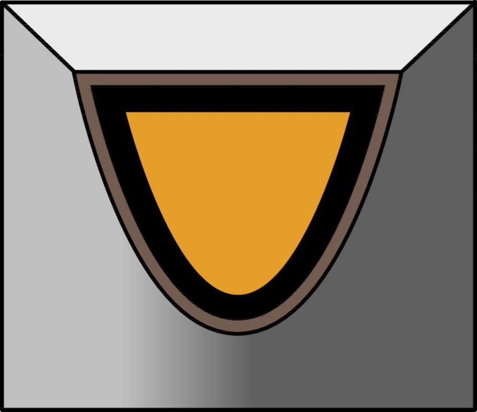

Composition: A PVD TiN coated high CBN content, solid PcBN insert having multiple cutting edges.
Application: Applied in roughing to finishing of gray and hard cast irons. Also used for finishing chilled cast iron and fully pearlitic cast iron. The solid PcBN insert offers better security and shock resistance compared to tipped PcBN inserts, while also enabling deeper depth-of-cut capabilities.
