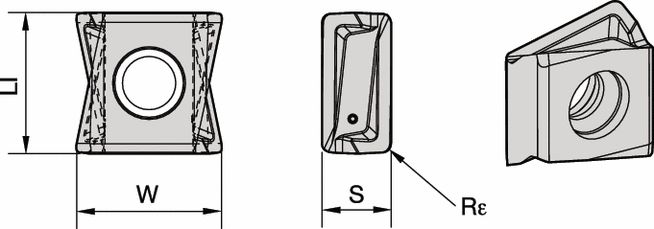

    Drawings for 6969913
    Material Number6969913
    ISO Catalog IDLNGQ120604ELGEKT4
    ANSI Catalog IDLNGQ120604ELGEKT4
    GradeKCK20B
    [LI] Insert Length 13 mm
    [LI] Insert Length 0.5118 in
    [S] Insert Thickness6.35 mm
    [S] Insert Thickness0.25 in
    [W] Insert Width 13.504 mm
    [W] Insert Width 0.5316 in
    [Rε] Corner Radius 0.4 mm
    [Rε] Corner Radius 0.016 in
    Cutting Edges per Insert4
