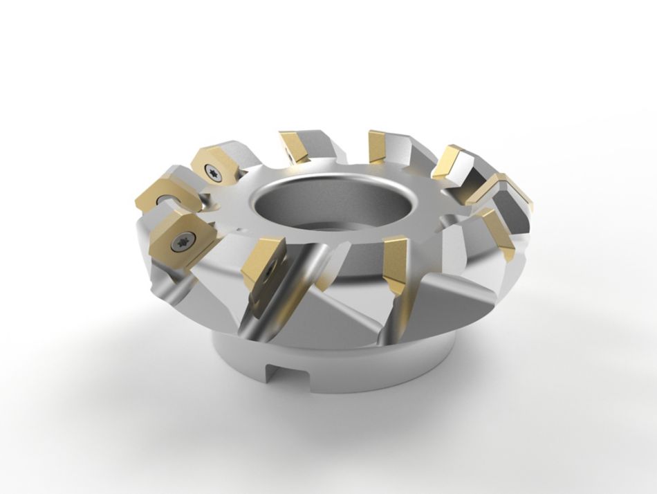

Due to its positive lead angle, face mills like the KSSM 45º shown here cannot be used to machine a square shoulder.

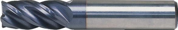

Though end mills are also available with indexable inserts, solid carbide tools like this HARVI™ I four-flute, center cutting end mills are the preferred tool for finishing operations and high-performance roughing.

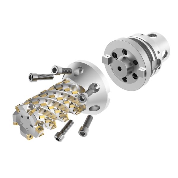

Kennametal HARVI Ultra 8X with Taper Flange Adapter Mount and Bolts
This HARVI™ Ultra 8Ximage illustrates a shell mill’s similarity to a helical end mill, as well as the use of an arbor mount for maximum security and minimal runout.
