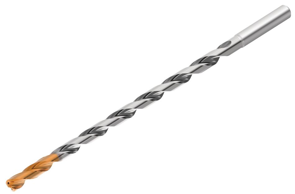

KenDrill™ Deep HPR/SGL • 20 x D • Internal Coolant • Straight Shank • Metric
Solid Carbide Deep Hole Drill for Cast Iron and Steels
Material Number7081747
ISO Catalog IDB272Z05500HPRANSI Catalog IDB272Z05500HPR
KenDrill™ Deep HPR - 20 x D - Internal Coolant - Straight Shank - Metric 7081747 - Kennametal

  • Tool Dimensions: 2flute/4margin/coolantTool Dimensions: 2flute/4margin/coolant
  • DIN number 6535DIN number 6535
  • Through Coolant: MQL (Minimum Quantity Lubricant): DrillingThrough Coolant: MQL (Minimum Quantity Lubricant): Drilling
Drawings for 7081747
GradeKCK10A
[D1] Drill Diameter M 5.5 mm
[D1] Drill Diameter M 0.2165 in
[L] Overall Length 173 mm
[L] Overall Length 6.811 in
[L3] Flute Length 130 mm
[L3] Flute Length 5.1181 in
[L4] Maximum Drilling Depth 117 mm
[L4] Maximum Drilling Depth 4.6063 in
[L5] Drill Point Length1.55 mm
[L5] Drill Point Length0.061 in
[LS] Shank Length 36 mm
[LS] Shank Length 1.4173 in
[D] Adapter / Shank / Bore Diameter6 mm
[D] Adapter / Shank / Bore Diameter0.2362 in
  • DrillingDrilling
KCK10A
KCK10A
Composition: Multilayered PVD AlTiN-based coated submicron grain carbide with superior surface finish.
Application: First choice for cast iron. This grade utilizes a newly developed coating combined with a state-of-the-art surface condition to offer extraordinary wear resistance in abrasive materials at elevated cutting conditions with improved performance consistency.
  • Proven performance with our HPR drills geometry, featuring our heat and wear resistant KCK10A grade.
  • High productivity with speed four times faster than conventional drills.
  • Longer tool life in steel and iron compared to competitors.
  • Bottom-line savings from increased metal removal rate.
