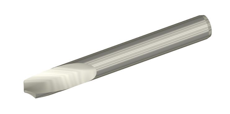

KenDrill™ Spot • 120° Spot Angle • Straight Shank • Metric
Solid Carbide NC Spot Drill
Material Number1198724
ISO Catalog IDB501Z04000ANSI Catalog IDB501Z04000
- P Steel
- M Stainless Steel
- K Cast Iron
- N Non-Ferrous
- S High-Temp Alloys
Drilling: Convex

K10
Composition: Uncoated, highly wear-resistant fine-grain carbide with enhanced hot hardness properties.
Application: Best suited for dry and external flood coolant applications in aerospace materials like high-temperature resistant materials and wrought aluminum alloys. Due to its high wear-resistance, this grade is also applicable for cast iron machining at low to medium speeds.
- Solid carbide spot drill for pre-centering operations, leading to improved hole positioning.
- Designed for spot drilling only, it comes with a very short flute length
- Well suited for HSS drills with point angles greater than 120°, and for any tapping operations.
Application Data
Non-Coolant Spot Drills • B50_ Series • Grade K10 • Dry and Flood Coolant Drill • Diameters 3–20mm • Metric
