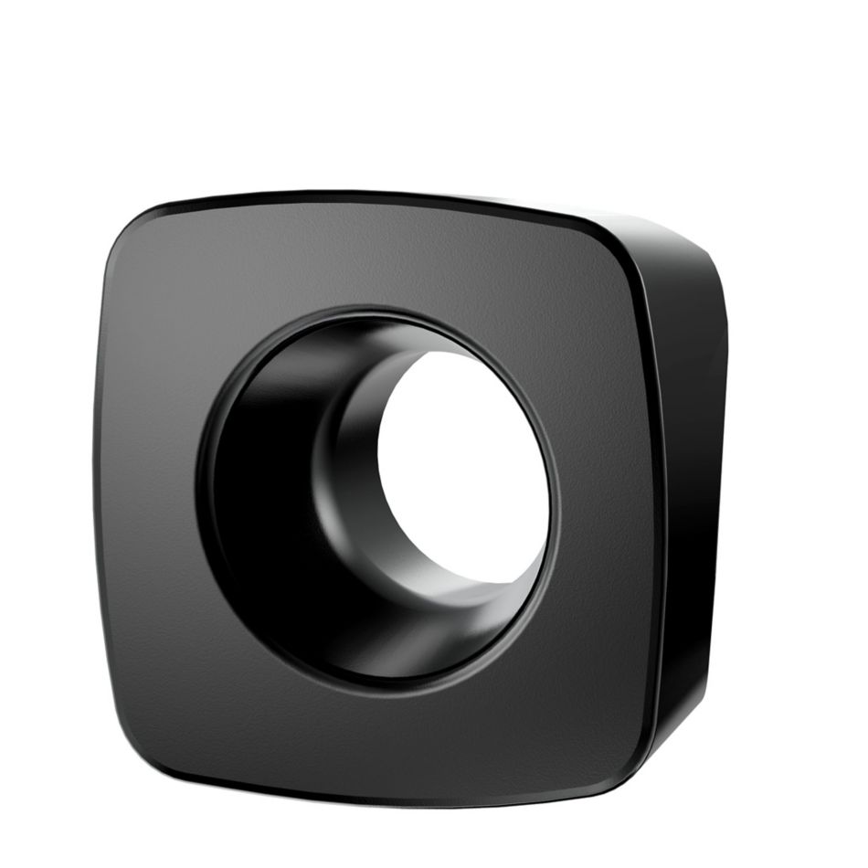

7792VXP06 Series • Carbide Insert • XPLT-D41 • Medium Machining
7792VXP06 Series • Carbide Insert • XPPT-D41 • Medium Machining
7792VXP06 Series • Carbide Insert • XPPW-D • Light to Heavy Machining
7792VXP06 Series • Carbide Insert • XDLT-M41 • Medium Machining
