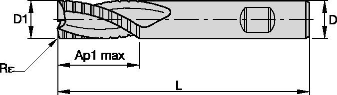

  • Helix Angle: 45°Helix Angle: 45°
Drawings for 3331488
Material Number3331488
ISO Catalog IDHPRST625S4125
ANSI Catalog IDHPRST625S4125
GradeKC643M
Adapter Style Machine SideWeldon
[Re] Corner Radius 1.025 mm
[Re] Corner Radius 0.04 in
[Z] Number of Flutes4
[D1] Effective Cutting Diameter15.875 mm
[D1] Effective Cutting Diameter0.625 in
[D] Adapter / Shank / Bore Diameter15.875 mm
[D] Adapter / Shank / Bore Diameter0.625 in
[AP1MAX] 1st Maximum Cutting Depth31.75 mm
[AP1MAX] 1st Maximum Cutting Depth1.25 in
[L3] Usable Length31.75 mm
[L3] Usable Length1.25 in
[L] Overall Length 88.9 mm
[L] Overall Length 3.5 in
KC643M
KC643M
Coated fine-grain grade with PVD multilayer (AlTiN). KC643M™ is a very thin and hard PVD coating particularly suited for cutting steel, cast iron, stainless steel (wet), and titanium (wet). This grade can be used for materials with hardness up to 52 HRC.
