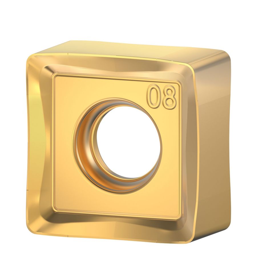

KSSM8+™ • Carbide Insert • SNHJ12-LD • Light Machining
Face milling insert with eight cutting edges, precision ground.
Material Number5418803
ISO Catalog IDSNHJ120608ENLDANSI Catalog IDSNHJ442ENLD
Inserts for KSSM 8+ - SNHJ12-ELD 5418803 - Kennametal
$35.81/each

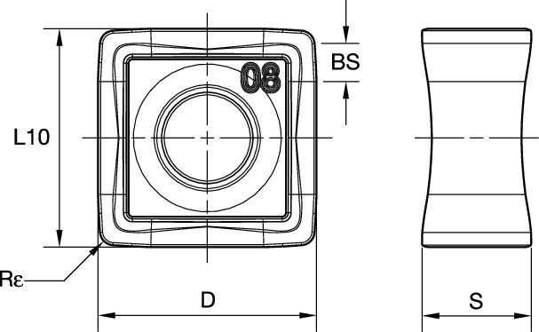

Drawings for 5418803
GradeKC520M
[D] Insert IC Size12.7 mm
[D] Insert IC Size0.5 in
[S] Insert Thickness6.35 mm
[S] Insert Thickness0.25 in
[Rε] Corner Radius 0.8 mm
[Rε] Corner Radius 0.031 in
Average Chip Thickness [HM]0.055 mm
Average Chip Thickness [HM]0.0022 in
Cutting Edges per Insert8
KC520M
KC520M
Coated carbide grade with TiAlN coating (PVD). KC520M is a carbide grade developed specifically for general machining of ductile cast iron. This grade can be used with or without coolant.
  • Precision ground insert for best run-out and tool life.
  • Positive rake face for soft cutting action
